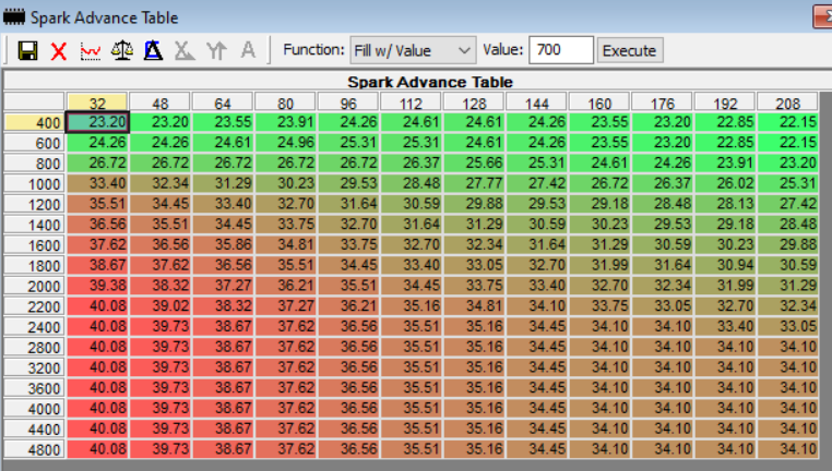

Spark advance...
RBob.

It's a MAF car, Im adding screenshots of my enrichment and spark tables for @RBob as well.
First, Enrich tables:
Next, Spark Advance (My PE Advance table is zeroed out):
The total .bin is attached to this message as well. All of this is being applied to a 350 .040" overbore with 10:1 compression, iron 1969 Z/28 double hump heads with beehive springs, 1.5 rockers, and a COMP 8-502-8 camshaft. It shockingly does not ping with that much spark in it, but it does see some false knock on a hard downshift when I stab the throttle, then recovers just fine.

It is usually worthwhile using a timing light and checking that the actual SA matches the commanded. Been down that road.
RBob.

What is your base timing set at?
Fred

My base timing is the factory 6* at the distributor as well as in the tune file.
