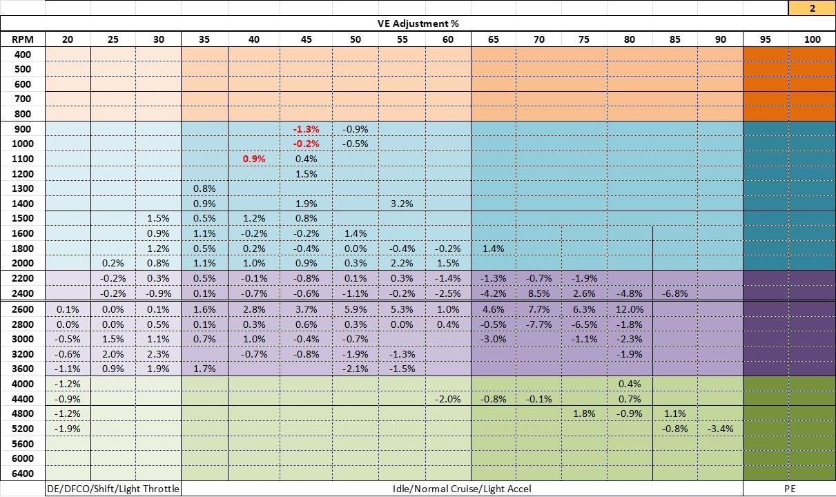

From experience, a BLM of, let’s say 137 does not translate into add 7% to VE (137/128). I usually start with around 50% of that, so 3% in our case. Don’t forget MAT plays a role. A heat soaked MAT will lean out fuel at WOT PE depending on your tune.
But again, I did away with chasing BLMs on $8D. BLM is disabled and I run on INT only. More accurate for VE tuning in my opinion but most importantly better consistency.

New_VE = Old_VE x (1+((128-INT)x.0034))
Is there a worksheet available for locked BLM INT tuning using tunerpro's INT log's

Originally Posted by STEALTHWRAITH
Trying to fine tune the VE tables going off INT with a locked BLM reading info from older non active threads where I was able to at least find the formula for INT to be
ummm!
Example using this formula
Average INT =132
Old_VE = 80
132 = lean = need to add fuel = need to increase VE
New_VE = 80 x (1+((128-132)x0.0034))
New_VE = 80 x 0.9864
New_VE = 78.9
Does not look like the formula is right. It removes fuel instead of adding!
I proposed:
New_VE = Old_VE * ((((INT/128)-1)*0.5)+1)
You can change 0.5 for 0.25 or 0.33 if you want. The point is to avoid chasing your tail by correcting VE based on 100% avg INT. I like starting with 50% of value but sometimes I’ll use 25% to fine tune.
Old Feb 17, 2024 | 06:08 AM
SbFormula's Avatar
Joined: Jun 2012
Posts: 1,370
Likes: 195
From: Canada
Car: '18 Chev Camaro SS 1LE
Engine: LT1 6.2L
Axle/Gears: 3.91
Re: Chasing BLMs
Not that I am aware of. I just built my own.

That is the million dollar question! I'm doing it my way but I am sure there are other ways. It took me many, many, many hours to come-up with this system. I have and advanced knowledge of Excel software, which really helped. So here's a brief summary:
  • I export TunerPro's data into a .csv file
  • I clean-up and organize the data the way I want it. It can be a tedious process, specially when you have lots of corrupt data. I use filter functions to analyze max/min on each column that I keep. I get rid of bad data. I also remove any open loop, PE, DFCO, cold engine and other irrelevant data for VE close loop tuning.
  • I export the data into another custom made Excel database.
  • Through Excel's custom programs and calculations, AVG INT values are populated into a table that mirrors my VE table in the tune. I have to interpolate part of the VE table corrections. Then, It will automatically generate a partially corrected VE table based on the data.
  • I just copy and paste the new VE table into TunerPro.
  • I go out, datalog, rinse and repeat.
  • I also datalog real AFR from a gauge, to keep an eye on things.
Initial AVG INT generated by Excel, mirroring the VE table. At the top I also get the AVG INT by BLM cell.
Number of counts (frames) per BLM cells and also by VE table cells. Tells you where the engine spend most of its time.
AVG INT for cells with 10 counts (frames) or more. This concentrate the correction only on cells that were meaningly hit. Sometimes I use 25 instead of 10.
Proposed % correction to VE. That is a 50%, sometimes I use 33% or 25%. This is used to generate the new VE table. Once VE table is generated, I have to smooth it out to fill some blanks.
The AFR gauge averages
Long, boring, and tedious process using an antiquated system not very accurate.
IMO, you don't need BLM or INT to be exactly at 128. Chasing this can become obsessive and accomplishes nothing really. It's way overrated. As long as the ecm is capable of being close to 128, that's good enough. +/-8% error is more than acceptable for me. I don't really care much about close loop operation. As long the ecm does not have to swing the INT too much and the AFR results are as close as possible to 1.0 lambda (14.7 in my case). Sometimes, you might have to modify the 02 sensor voltage windows to get the AFR corrected even if you get a nice 128. Also, at idle, I find it's better to richen the AFR to smooth out things. This can only be accomplished by modifying 02 voltage windows.
