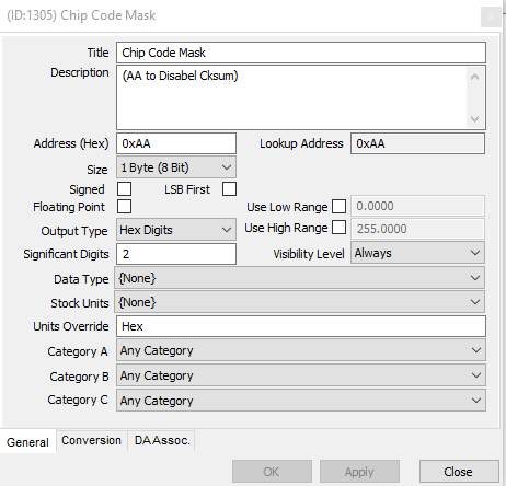

Thanks. In the $8D XDF I found "Chip Code Mask".
It's currently set to 8D. So I change it to AA?

So I realized I had to change the 08 to AA in the XDF file. So I tried that.

Ok I think I'm understanding what's going on...
Turns out you do need to change the 8D to AA. Not the way I did it above my previous post.
Haven't test driven the car yet, but hooking the laptop up to the Ostrich, I can generate a emulator vs RAM contents verification failure if I don't upload a the bin with AA before starting emulation.
It seems the order of operations necessary for emulation is...
1.) Open Tunerpro
2.) Open bin I want to start emulating with
3.) Change location 0x08 to AA and upload to Ostrich
4.) Activate emulation
When I follow those steps, I get successful verifications.
I'll have to try this out with the engine running and see if it works.
