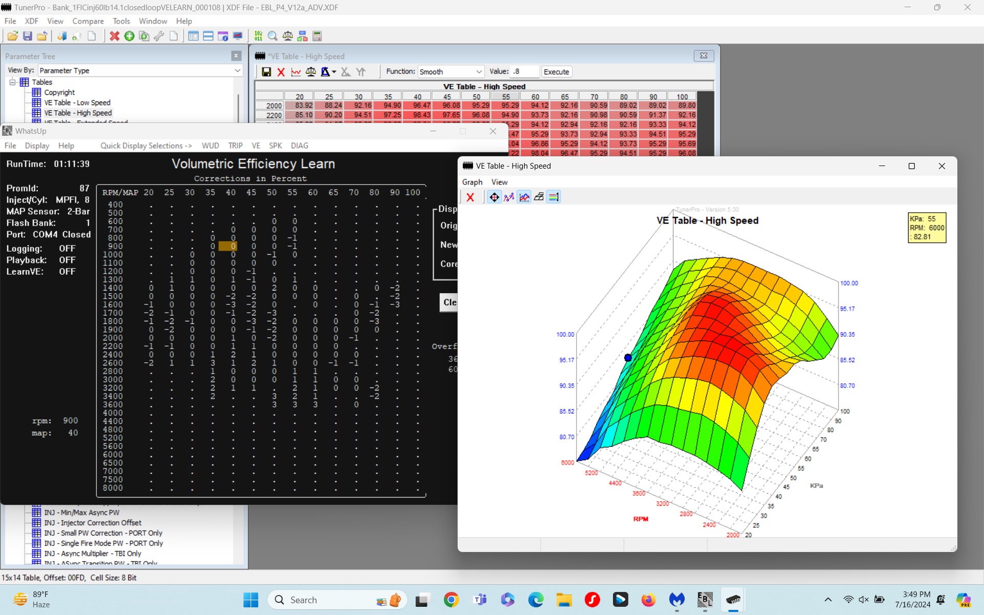

Time for an update on injector problems. I pulled the Dekas and now have FIC 60lb injectors in it. Noticable differences. The idle surge that would come and go is gone. Idles and responds to small throttle inputs noticibly smoother. The rpm surging that came when the fans turned on is gone.
There is still a discrepancy between wide band to narrow band but much less now.
Tuning using VE learns are way more consistent from session to session. I raised the VE learn RPM threshold for closed loop so as to hit more areas. I have to run closed loop for smog so prefer to tune closed loop.
Now a question on the shepe of the VE tables. I know the old adage of give it what it wants, but I've never run into VE tables with these shapes. Also posting is the last VE Llearn showing it's down to minimal changes now.
Thoughts on these tables-the shapes? Also what does it mean when it says overflow on the ve learn?

Not much help with your questions. But when you say you moved the VE Learn RPM Threshold. Where is that? Are you using EBL P4 or Flash?
Also, I assume because you are doing closed loop tuning your WOT areas are lower due to entering PE? Seems weird to me looking at a Low Speed VE table with the high area where it's at on yours. Mine is all highest on the 100 Kpa side of the graph.

BLM-RPM learn threshold in EBL P4. My PE is set up to 90map and 80 tps so should not be effecting up to there.
Okay yep I remember that now...been so long since I've done any kind of closed loop tuning I couldn't remember.
