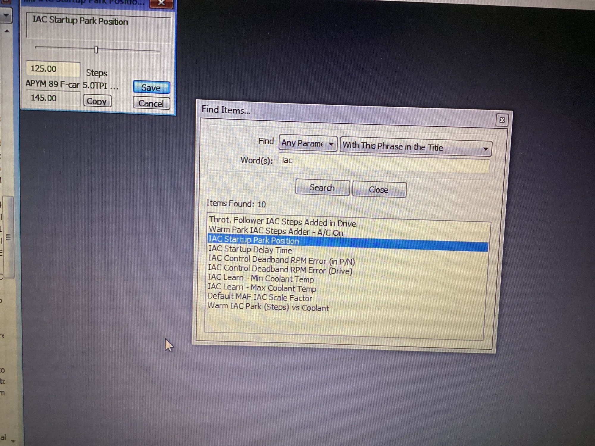

Now I just need to figure out why my idle speed wont automatically go down while driving. For example: Cold start, 1200rpms, it stays there forever until I STOP the car and let it idling. Then it slowly settle down to normal 550rpms in drive and wont go up. (Function normally).
Attached is the picture with the iac parameters. I am pretty sure I can fix that by one of the parameters. Does anybody have an idea and can explain me the deadband error and the maf scale factor?
