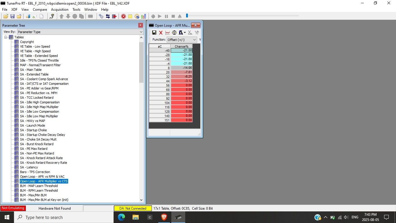

Ok, so no progress on the idle.
I zeroed out the Open Loop - AFR Multiplier vs. CTS and Im seeing 11.5 - 1 AFR at 89 deg C coolant temp.
I attached a datalog file and you can see the WB AFR start at 14.7 - 1 then plunge to 11.5 AFR after about 15 sec. Cold warmup seems noticeably better than my previous post.
No idea why its switched around.
Attached a screen shot of the AFR Multiplier/CTS and the data/WUD replay file
Thanks in advance
