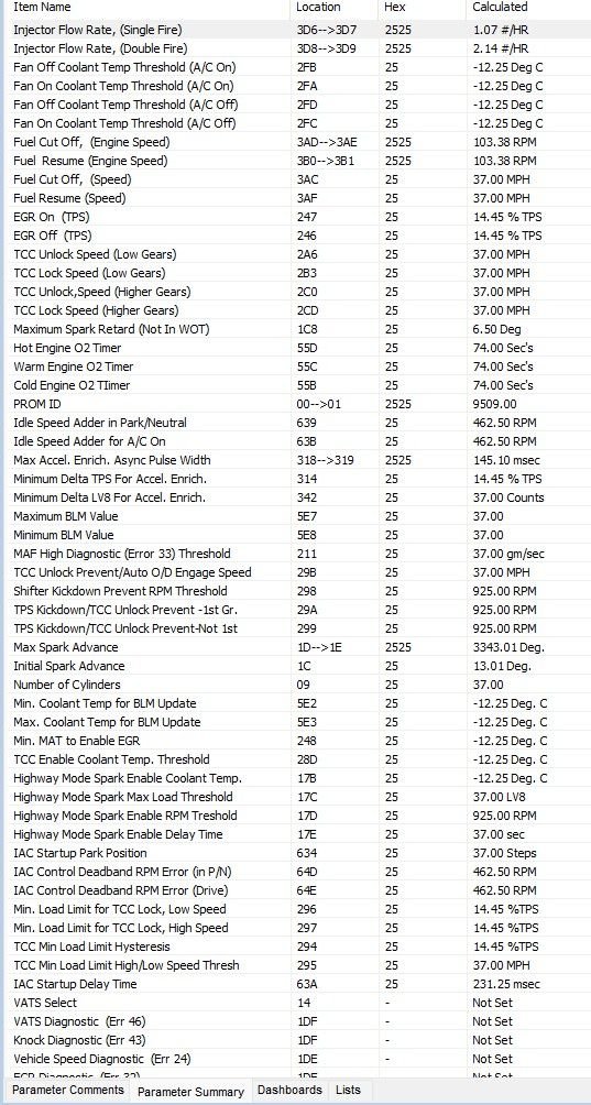

So I'm working on my 87 Camaro IROC ECM 1227165 MEMCAL ACXT. I won't bore you with details of why and how, but long story short, I downloaded the MEMCAL using the TunerPro RT.
So I compared the data from my chip to the exact file I downloaded from Gearhead-efi (same ECM and ACXT)....which is NOT a match. Something is not right?!?!?!?!? Oh yeah, I am using the $32B XDF file.
Here is mine:
and here is the one I downloaded from Gearhead:
Besides the outrageous temps for fans...my main question is???? THE INJECTOR FLOW RATE!
I hope someone can shed some light on this, some sort of explanation?
Now kicker #2 is, I bought another MEMCAL for same ECM but it's for a 1988 LB9 305 Camaro, EPROM AKFS. I downloaded that data and guess what?
It matches exactly to my original data....I mean the injector flow rate is baffling me....not sure what to do with this now?
BTW, I am getting CEL codes and one of them is 51 but that's another story.
I downloaded the data to check if it was corrupted or not.....so is it? Is the AKFS corrupted also in the same way? The odds of that are impossible, so what gives?
Anyone with any info....chime in
oh yeah...lastly....the spark vs RPM vs Load chart looks like this from my MEMCAL hahahahahah

When you’re doing a read are you using a hdr1 ? Are offsets correct ? With chip in the burner you can verify chip to buffer to compare data. Sounds like a bad read.
as far as the code 51 have you tried a different 1227165 ecm ? It’s not a real common thing for a chip bit flip but can happen you will see the checksum won’t match. But sounds like a bad ecm over a prom.

Thank you TP for taking the time to read and answer my post.....
I used the TunerPro RT to read it and save it....Honestly not sure what HDR1 is, but if it's a hardware question, then I used Moates' gear. My first try at this and not by choice but necessity. I found it to be extremely easy actually, especially when you got time to burn and learn (I retired at early age)
Yes, a new/used 165 ECM is on the way and matter of fact should be at the door today....it comes with a MEMCAL ABTT (88 Vette) so I will def read it and see what those fuel parameters look like....I've seen other BIN files from F-Y cars and they look standard...the 20 #/HR or 23/24 #/HR so we will see.....
ABTT file from gearhead:
I will read it and compare to above...hopefully they match. After that, delete the VATS, change the fan temps, 9th inj delete and we gonna send it!!!
I will update....

The hdr1 is a header adapter to put under the memcal to read the proms bin. I’ve seen cases where this can mess up the data in a read. If offsets are wrong for the 27c128 data will looked messed up as well.
https://support.moates.net/programmi...using-offsets/

oh i see....I read it with "burn2" from moates....when I get the ECM, I'm gonna read that EPROM and reread the one I burned yesterday to see if anything has changed.
I've double and triple checked if all the chip prongs were properly seated in their proper seats and grove pointing right way....all was 100%.
So let me ask ya...if I get screwed up data from the EPROM I get with the new ECM, should I contact moates and tell em the issue or is there something I should look for, fix or try different hardware? 🤞

i understand you used a burn 2 but what were the chip offsets ? You used a hdr1 or unsoldered the chip for a read ?
ill be home in couple hours, I'll make a screen shot of what I'm doing and yes, I unsoldered the chip from the original MEMCAL board and purchased the GP1 ZIF socket....so it grabs the chip pretty good. At least in my opinion....
Update...
I just read more info ref the offsets...it makes total sense. I did not use any offsets cause I was under the impression the software would do it automatically for the user. I mean, you set physically the chip type, you'd think software would know what you got in the buffer to burn, Right? Great, can't wait to get home now.....
My gwad, you don't even know how much I appreciate your knowledge and patience!!! Thank you for pointing out those little important things sir

A zif is great for swapping tunes. I’ve seen failure with long term use so really avoid them after a tune is done. If it’s a moates g1 the zif comes off and just use the dip. Loading a 16k file then do a read Chan change offsets in flash and burn not sure about the tunerpro software.

Doing a burn most use a 27sf512 based chip just burn to the upper section. Always check offsets and verify after a burn.
OK...I'm home and went straight to the files and TunerPro.
Here is what I found...According to moates' support:
Uploaded the file and everything auto populated itself correctly! Its nice to just make sure
After that, programmed the chip then verified with buffer and all done....
