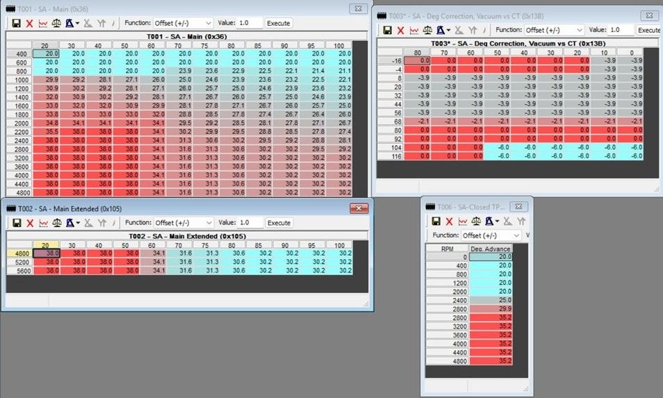

Here's what I have.
That's for: https://www.thirdgen.org/forums/engi...st-intake.html
GM Crate SP383 Deluxe Aluminium Fast burn heads, 9.6 compression running on 91 + Boostane.
With the '7730, The ECM runs SA Closed TPS from a different table. In idle mode there is SA correction to help with stabilizing idle +/-5*. It runs anywhere from 15* to 25* at warm idle. PE SA adder is set to 0* and CT SA table correction plays a role depending on CT. At operating temp, there is no CT SA Correction. Highway SA mode is disabled.
I did tune WOT SA on chassis dyno and there was no significant difference on between 28* and 32*. Something like 7whp from 28* to 30*, and 2whp from 30* to 32*. We settled at 30*.
The rest of the table was not tuned with chassis dyno. So it can be off in certain area.

Forgot to mention, I use $8D, S_AUJP V6 and the Cold SA feature is disabled. So under a certain CT threshold, the ECM DOES NOT use the 100KPA MAP column for SA.
