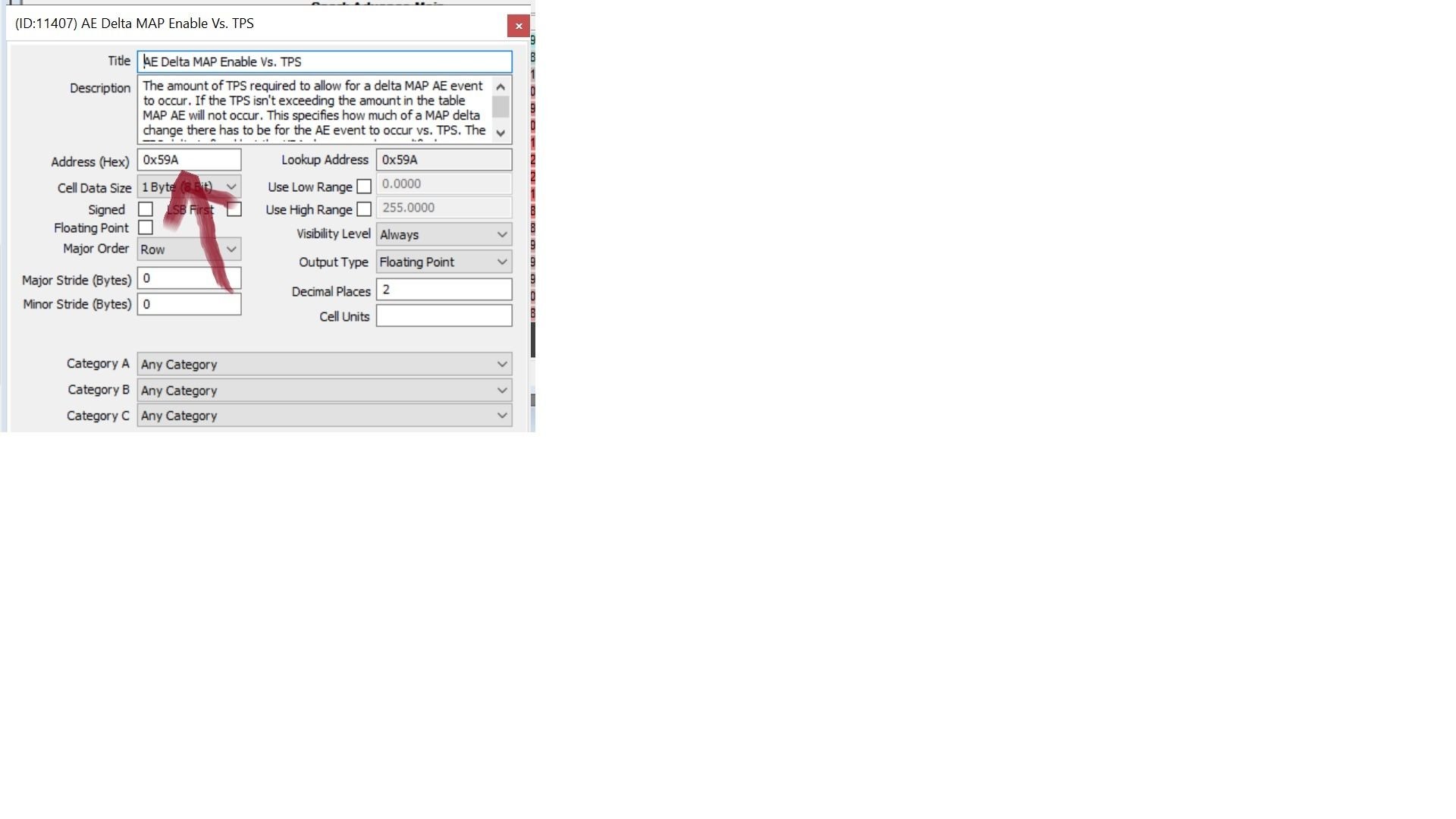

It would be easier to copy definitions from saujp to an axxd xdf. Almost everything with address Xxxx is identical. So you pull your AE parameter and look at the address. Say it's address is x567, it's probably transferable. So paste it into an AXXD xdf and look at it. Does it make sense?
If the address on the saujp parameter is x2567, that 4th number is a no go.
Copying my code into saujp, is NOT beginner code work. You need to understand a LOT. Not the first thing you should try to do.

See the two I'm talking about? Any OEM table with 3 number addressing is PROBABLY good to go. But you need to be very careful editing.
Any table with 4 number addressing is a NO GO.
Any table NOT OEM is a NO GO.
Transfer the defined tables and parameters to an axxd xdf and you're all set.
