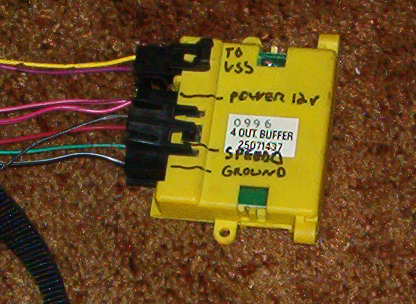

It would be on the Passengers side by the computer Here is a pick of it.......

I beleave that your buffer should be the same part number as the one in the pick if so you can get one out of a junk yard from a mid 80's olds Delta 88 for shure don't know about any other models but that is the one I use for my 91 gauge cluster and it works great.
The green wire is 4000ppm that lead goes to you speedo the red wire goes to you cruise the brown goes to you computer for the lock-up and other things both red and brown are 2000ppm

i know what your talking about i have taking the computer out a couple of times i put a new one in i saw that piece do you think thaat will fix my problem? noone has ever even told me about that go figure lol.oh yeah if i find one it has to be the same part# right? and it will just plug right in right?

while it does seem unlikely, one of the buffer outputs could have failed. the junkyards will probably just about give them away given the number of people that actually buy them, and it's only 5 minutes worth of work to try, so i say go for it.
(also, your 89 will have an electonically driven speedometer)
