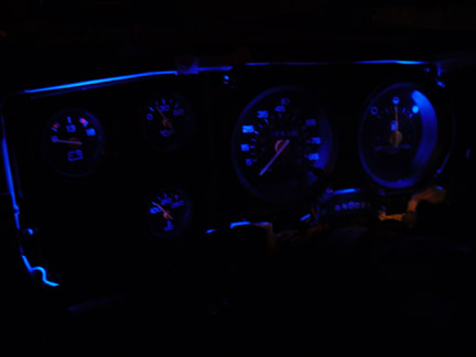

It's alot of trouble for one bulb. And adding only one blue light will hardly achieve the effect that most are looking for. If you can read the gauges then just drive.
Now if you are serious about having some killer blue light radiated from your gauges and reflecting off your white T-shirt at night than you have to forget those blue bulbs (they only make the light darker) and go with an LED conversion. There's an excellent tech article about it. I did it on my friends 89' Suburban with blue LED's (2 per socket). It looks sick. The soldering and resistors weren't easy on those little sockets, but luckily the burb only has 6. Our camaros have 11.
Let me know if you are interested, cause I could preassemble all 11 and sell them to you. Now that would be a worthy reason to pull your gauges.
