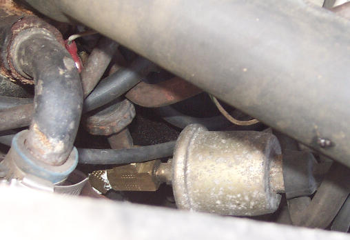

Try moving your steering column up and down, try starting the car with it fully up and with it fully down.
Since you were going to pull the instrument face plate/lens, you probably pulled your tilt wheel all the way down (assuming you have tilt) to get the face plate out. You may have some flakey wiring under dash or on the column that you moved and got to make contact.

I'm sorry armac, but I will have to disagree with you on your post. The oil pressure sending unit, in addition to operating the oil pressure indicator in the instrument panel, acts as a backup to the fuel pump relay only if the ECM receives a code 54 (fuel pump relay failure), it will then turn the fuel pump on when oil pressure reaches 4 psi. The fuel pump will work regardless of whether the oil pressure switch works or not as long as the fuel pump relay works.

Morley, If you go back and check your manual, you will find that the oil pressure switch serves two purposes.
1. to act as a sending unit to the oil pressure gage in the instrument panel and 2. to act as a back-up to the fuel pump relay in the event that the ECM gets a code 54 (fuel pump relay failure).
Please go back and re-read my post and you will see that what you are saying is the same thing that I posted with exception of your stating that the oil pressure switch and sending unit are two completely different units.

I'll compromise with you, we are both right in a way. On the 2.8l engines, they had two units mounted one above the other. one was the oil pressure sensor and the other was the fuel pump/oil pressure switch. On the 5.0l and the 5.7l engines, there was only one unit and it was the fuel pump/oil pressure switch. this unit served the dual purpose of oil pressure sensor and fuel pump/oil pressure switch. Okay!

No, actually the V8's also had/have 2 seperate components, a switch and a sender. That is how my car was/is set up, a "log" with a threaded fitting going into the block back by the dist, a switch threaded into it sitting vertically and a sender threaded into it at about a 45* angle.

In my previous post, I should have mentioned that it depended upon the year and model car. There was a rather interesting (and heated at one point) post last month I believe, where someone had gone to a parts store to get a unit for his car and they sold him the wrong one. but, anyway, mine is a 1989 Iroc with the 5.7l and it only has the one unit. The 2.8l have the two units similar to yours but the design has changed a little. I don't know what year they decided to go with just one unit instead of two. However, this is how my car is and that's how it is in my GM service manual. So can we agree that we are both right in a sense. The earlier models had two units and the older models had just one unit in their 5.0 and 5.7l engines.
