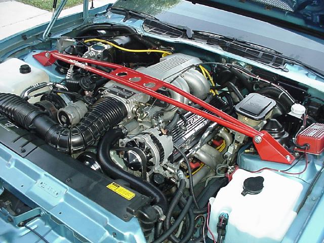

Here's a few more locations i found while i was looking for a place i liked to mount it.

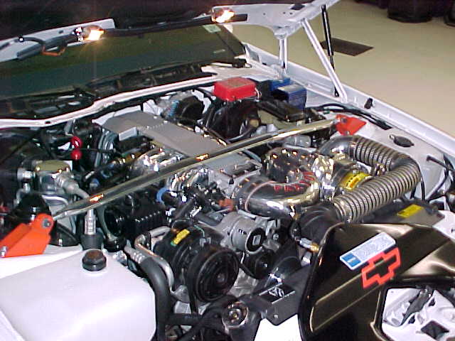

last one

thanks man...these pics really help! guess they all work well....kind of like the one on the driver side fender..easy to get to. thanks 3gc!

Heres mine
Old Nov 1, 2003 | 01:01 PM
88txiroc's Avatar
Posts: 1,195
From: San Antonio, TX
Hey Tuned Port,
Great minds think alike.................

Originally posted by 88aziroc
Hey Tuned Port,
i was planning on mounting mine there, but i just pulled the charcoal canister and mounted it right to the body there
