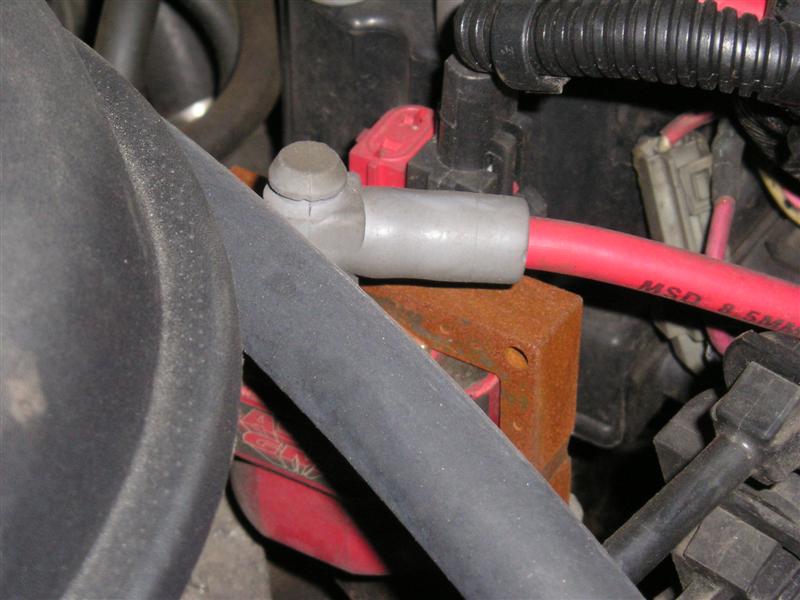

Sorry fellas, I know this is an old thread but I did a search on msd wiring harness and found it. I was wondering what coil you guys used and what harness part number you used. I went to hook up my msd box with my Blaster GM coil (8226) and the harness that I bought would not fit the coil. The coil has 4 pins and the harness I had only had 2 pins. I told summit exactly what I had and that is what they gave me. Any help would be appreciated. I want to be able to do the ole quick switcheroo too if need be. Thanks.
you only need those two pins, the coil terminals are connected internal to the coil
Then what two pins does the harness plug into on the coil? Is this something I can just plug in and see if it works? And, do I just leave the other two pins uncovered? Sure would like to see a pic of someone's setup to see how they did this.
esmartuek: How's it going neighbor? I live on Pope AFB. What color is your car? Have you been driving it around on base?
once I find my camera, I'll post pics of mine
you have the dual connector coil, right?
Old Aug 8, 2004 | 06:00 PM
Dave Y's Avatar
Joined: Aug 2002
Posts: 676
From: Detroit, Michigan
Car: 04 Xtreme Blazer
Engine: 4.3L V6
found it

Old Aug 9, 2004 | 05:28 AM
iroczrockz's Avatar
Posts: 813
From: Summerville, SC
Car: 91 RS Camaro
Engine: 305 TBI
PERFECT!! Thanks Dave Y. I have been wondering about that. Now the headache comes with the spark plugs (getting them in and out and gapping them right) Thanks again Dave I was hoping someone had a setup like that.
