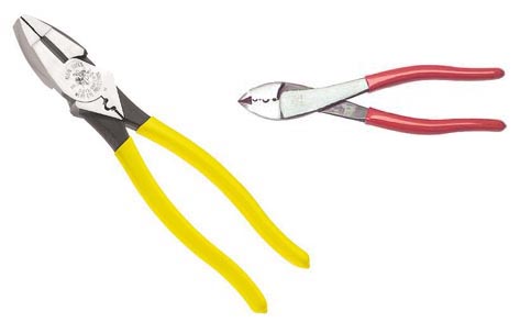

I found these 2 Klein crimpers while searching, people seem to have said good things about both. I can get either for about $20 at Home Depot. Would it matter which style I got? Any negeatives to either style?

The yellow style isn't even a crimper. It's just a pair of cutting pliers that happens to have one crimp spot behind the pivot joint. Pliers that crimp behind the joint suck, because you're forever trying to get the handle around the wire. The red-handled style is a great pair of crimpers. I have a couple pairs of those, along with the Snap On equivalent.
