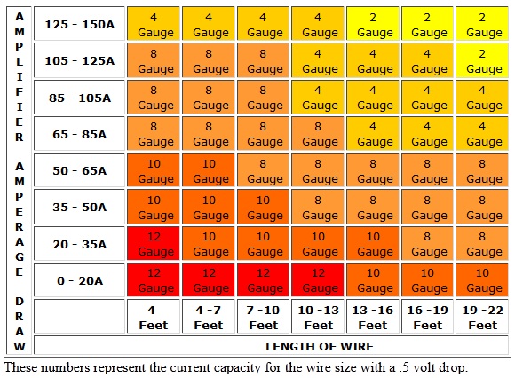

Wire selection
I have no idea why I've got 50 returns here, but just scroll down until you see the table.
<TABLE bgColor=#ffffff border=1 height=362 width=572>
<TBODY>
<TR>
<TD align=middle bgColor=#ffffff height=356 rowSpan=10 vAlign=top width=27>
<P align=center><FONT face=Verdana size=2><B>A<BR>M<BR>P<BR>L<BR>I<BR>F<BR>I<BR>E<BR>R</B></FONT></P>

These numbers represent the current capacity for the wire size with a .5 volt drop.
Make sure you choose an adequate gauge wire. When dealing with accessories such as lighting, the chart above may be a bit more conservative than you need, especially if you are able to shorten the wire lengths by use of a relay.

Great wire chart, Jim! Also, one other tip - never use solid wire, use only stranded wire. Solid wire will fatigue over time with vibration and eventually fracture, where stranded wire is more resiliant to flexing and vibration. The higher the strand count in any given wire gauge, the more easily it will flex.

Old thread but jim can you put up your wire table again. All I see is a bunch of html. Script.
See attached.
Attached Thumbnails Tech:  How to properly wire your electronics (Part 1)-amp-table.jpg
