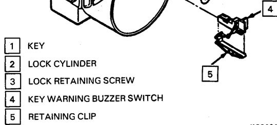

Items #4 & 5 are the two that I was talking about. They go in the steering column right below the lock cylinder and had to be removed to remove the lock cylinder.

yeah i just slid the lock cylinder out with no problems and slid the new one right back in. never removed the buzzer. im pretty sure that the actual ignition switch is the problem. today when i went to put it in start, the engine turned over fine, but when i let go and even took the key out the engine was still turning over. great now i have to pull all that shtuff out again!!!! How much do one of those do-hickeys cost about??
