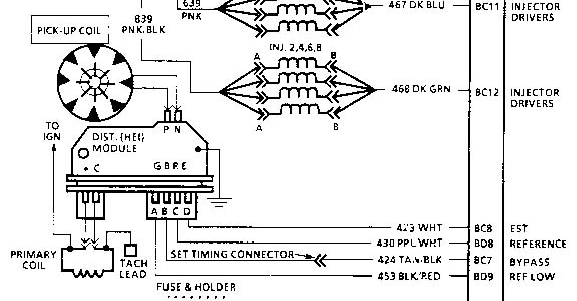

What does the EST bypass circuit look like?
What Pins on the Ignition Module should I check for good ground?

Posts: 6,127
Likes: 12
From: conway, s.c.
Car: 1989 Iroc-Z
Engine: 5.7L TPI
Hello JMatlock88,
I do have this picture that you can take a look at, Don't know if it will be helpful or not. If it is helpful to you, I can e-mail a clearer picture to you.

Here is a pinout of the ignition module. I am going to check continuity to the ecm (and check for ground or short) for pins A, C, and D. From my understanding, if these wires have issues, it may be the cause of the false RPM readings in the scan tool.
Joined: Apr 2000
Posts: 1,154
From: Stillwater, OK
Car: 1991 Formula
Engine: 355 DFI Superram w/ R-Trim
Transmission: Probuilt 700r4
Man, if that isnt the best kept secret! Okay, here's the diagram...
Basicly, I'm coming up with the same thing. I've already checked the knock sensor wire-- it's working great. So the only other ESC related wires are A,B,C, and D on the ignition module. Anyone agree or disagree here? I will also aligator clip the body of the distributor to ground just in case.
If none of these systems are faulty, I think I'm as far as I can go with this one.

FP is unchanged and good. Injectors = GOOD IDEA. I will test the resistance across each and report. They have less than a few thousand miles on them, but it's worth a look for sure!
As an update,
Swapped distributors with another stock one. I am not sure if this distrib is a good working unit, but I thought I'd try it. Now the symptoms have changed... I can't get it to idle to time it. (I am not a newbie -- the plug wires are on right and the thing is not 180 out.) I suspect a bad distributor. I'll swap in another stock unit and hopefully get back to where I was before.
As an update,

Thanks for the idea! Unfortunately, the original tach was removed (literally) and the problem still exists. I replaced the tach with an in-dash autometer, still the same problem. The only thing I havent done is cut the OEM tach wire. I am trying that today and will report asap.
