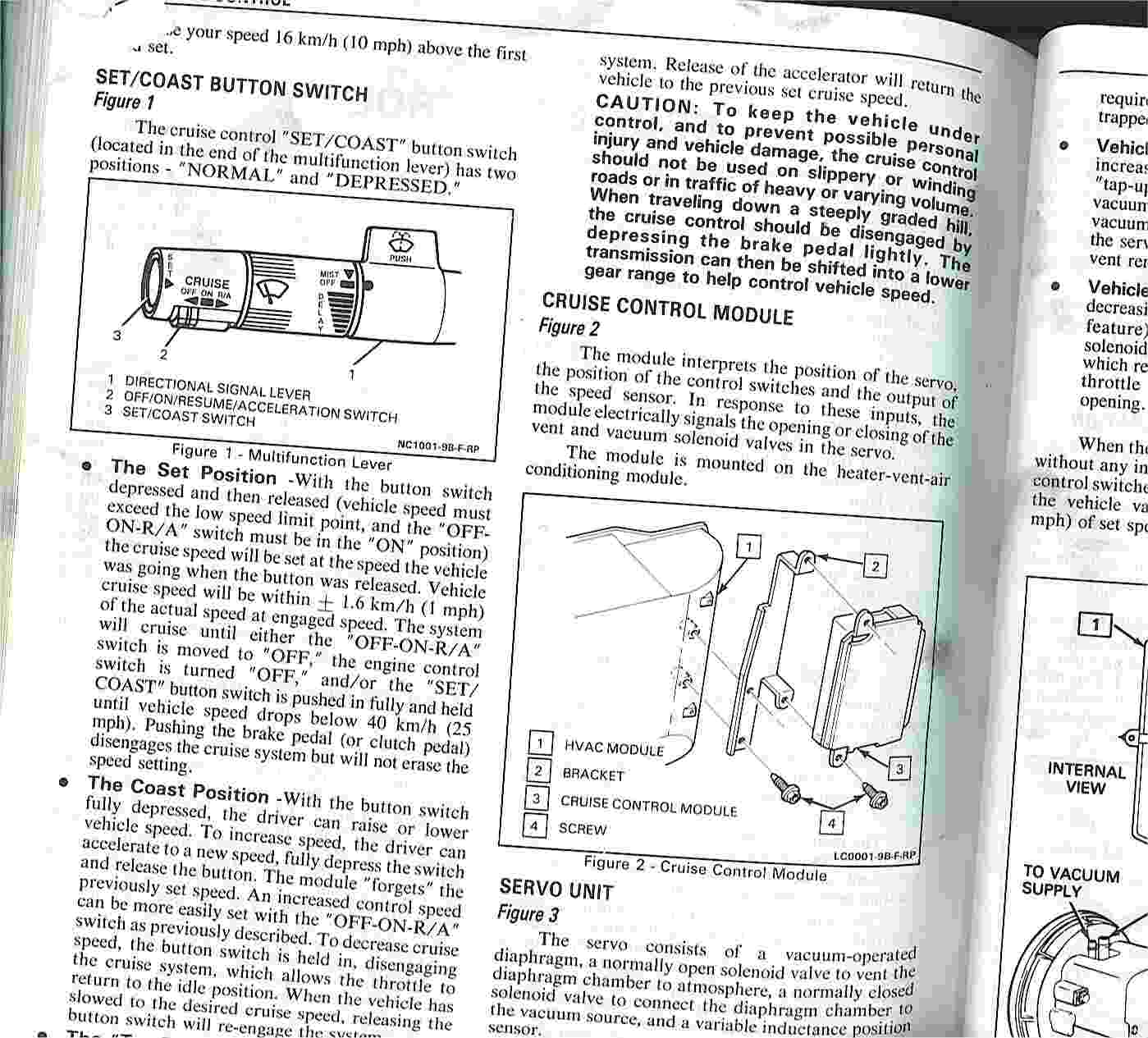

I have an 89 Camaro and finaly figured out why my CC might not be working. The wire to the lever on the steering column is unplugged. It's just dangling there at the base of column close by the ignition switch. lol..I've looked for about 2 hours now total and have no clue where this plugs into. Anyone have any idea or pictures as to where this plugs into? I might have cut it out by mistake when I first got the car when I was taking out the 5 miles of alarm and speaker wiring that was tucked up under the dash.

Does this help at all?
Edit: Sorry, next post should have pic/text.

The CCM is my guess...

My damn connection stopped on the upload of the image. I hope to heck it loads this time.
