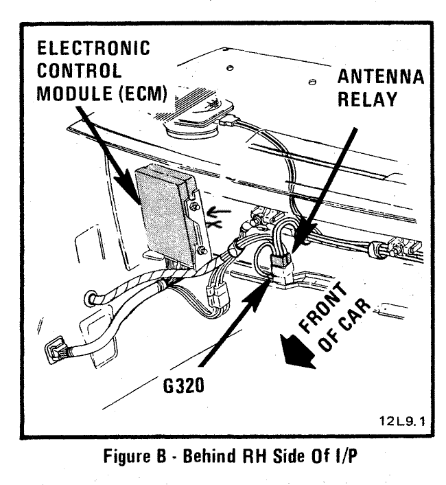

What holds the ECU in the car? Mine just kind of dangles there, I'm wondering if there's some sort of bolts or bracket? This is for a 1991 Z28.

It should be mounted in a bracket that is mounted to the dash metal support frame by two 7MM bolts. See picture.

Mine has a plastic pin on the top facing side of the ECM, and the 4x6 speaker bracket has a piece coming off of it for the pin to slot into to brace the top. I also have the two 7 mm screws on the bottom side.
