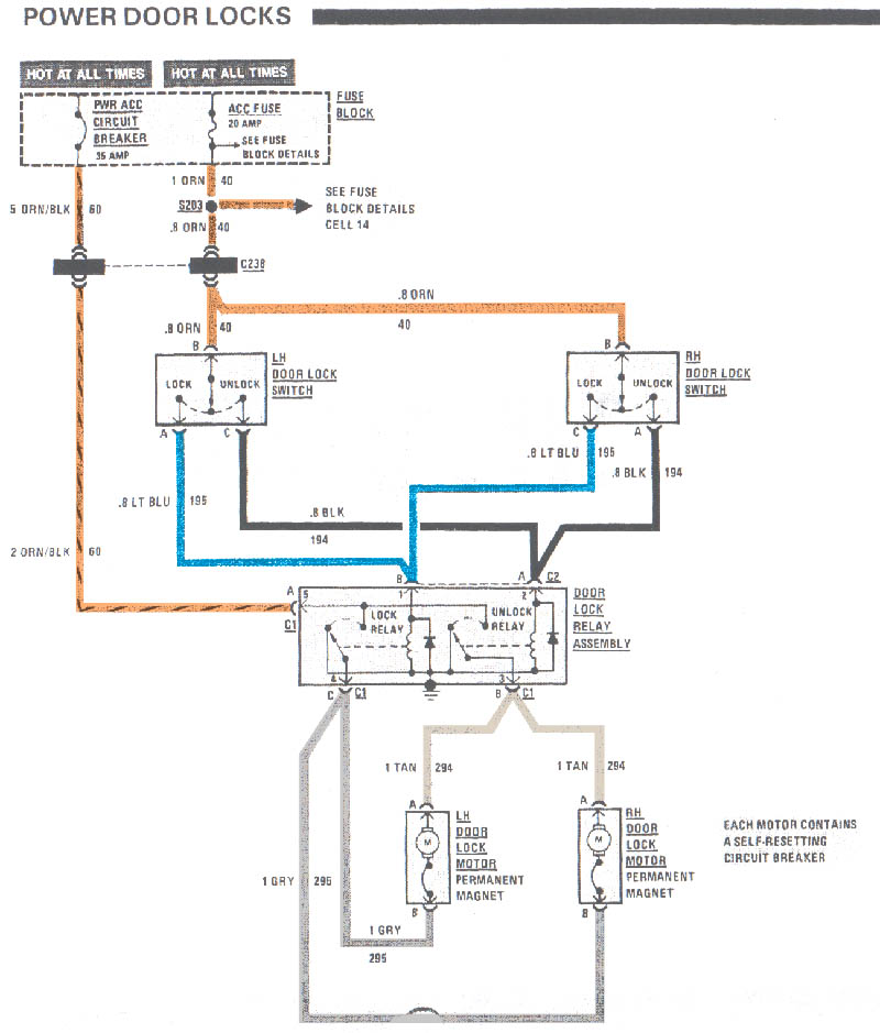

wiring up power locks in a non power lock door
where do i start i want to change from manual locks to power locks

I'm in the same boat too........
I have the control module and it has 3 wires orange,light blue & black wire and the actuator itself has 2 wires grey/tan ,so how do I connect everything and where to?....the tech section has nothing listed and my shop manual is useless!!!...and do I need anything else to add to make this work???....thanks in advance!!!

Here. this should clear things up guys.
Attached Thumbnails wiring up power locks in a non power lock door-powerlocks.jpg

Well that really gives us an idea,but I don't have the relay!!!...is there a model number to refer by on the relay module???

Sorry. Looked in the manual again.. but no part number. I think your best bet would be to inquire at a dealer. Or at least find out where the relay is located, and pick out one at a local yard.

Power hook up???????????
okay so far I got everything together and the actuator only "unlocks"....but I don't plan on hooking up into the fuse block at all!...I have two other power wire leads I can use and if they both are seperated and fused will the actuator lock then?...I am trying these theory's on my power inverter first before final installation!
