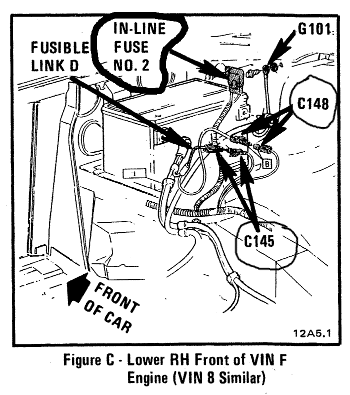

The 20 AMP fuse near the battery.

Here is a picture of the fuse, it will be as shown in this picture or mounted beside the radiator behind the right headlight. It is a In-Line fuse from the battery for the fuel pump relay and ECM.
