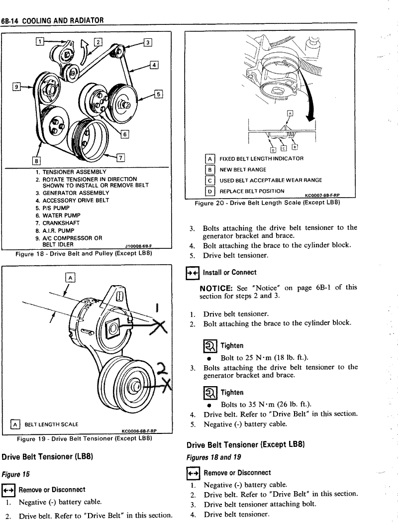

It's possible, what are the range markings showing on the belt tensioner and when you push down on the belt how far does it go down? See picture.

I tightened te ground on the batt, was a little loose (didnt notice until no), found another ground that was spliced into. Belt was ok. All in all, I went from 12.22v running, to 12.5 running.
I am running low, but I am holding voltage, not losing anything.
