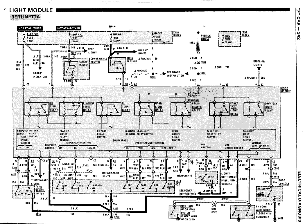

i just found an 84 berlinetta its mine for the taking but the digital speedo and tach dont work neither do the dash lights that light the fuel, oil pressure gauges ect, and all the warning lights come on and stay on (low coolant low oil check engine choke...) all the fluids are full any ideas if this might be a short in the wiring, anything would be useful i cant find any info on these gauges anywhere. please help. thanks

Do you think you could use this?

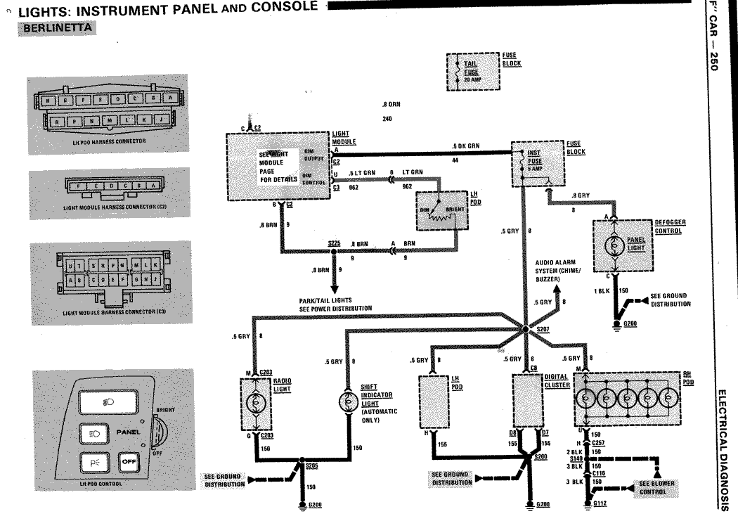

And this? BTW, welcome to the board!!

thank you thank you thank you,

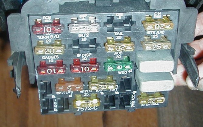

and while im thinking about it any one know where i can find a good picture of a berlinetta fuse block with the fuses in it

Here is a picture of a 1984 Berlinetta fusebox. I didn't check to see if all the fuses were the right ones !!!
