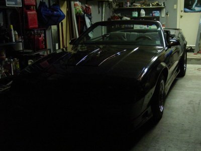

Defroster?? Rear wiper/washer??
Ain't got either!
Sorry guys, I couldn't help it!
Attached Thumbnails What is the 3rd switch spot for on my dash?-91z28vert.jpg
