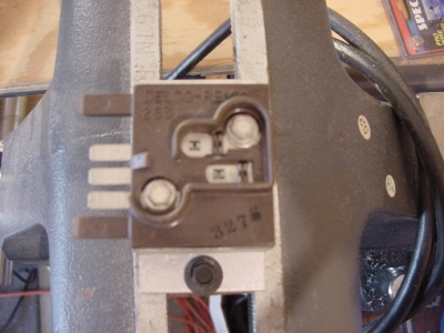

Another gauge lights problem
I just want to know the part number for the remote dimmer transitor this thing.
The dealership couldnt find it and i cant find it on the net. EDIT: Sorry i think thats it on the picture i used

It is a ACDelco part number 253-327 as you see it on the part itself. Over the years that number has been changed. Give that number to the parts department and if they are worth a sh*t they can cross reference it over to a GM part number for you and tell you if it is still available or not.

I called the dealership this morning and they still couldnt find the part so i search the net and the Ac Delco part number is D1509B and its 45.99.
I think im just going to go ahead and bypass it and not have any dimming action.

You can find this part at rocks auto parts for $23.95. Here is the link to it, click on parts search and enter this part number when the page opens. D1509B.

you can by the transister at radio shack for 3 bucks.remove the old transister( two bolts) apply dielectric grease to the new transister, bolt to heatsink reinstall done. I just did it on my 88 ta
