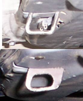

You may have the wrong motor/latch as compred to the strike thats on the declid... there is 2 different styles...
Top is older (on my 87), lower is newer style (on my 91). When they changed is beyond me. The strikes (pictured) are interchangable on the decklids w/o mods though...
