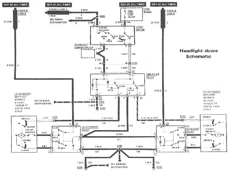

I doubt that the problem is the battery and charging system. You more likely have a problem with the end limit switch in the lamp motor. Since you can start the motor by turning the manual control ****, then it takes over, I'd bet the switch is not closing on the "open" end of motor travel.
I have no clue about electronics. I wouldn't know where to start to try to fix it. I also don't think the average shop would know either. What do you suggest?
The lights do flip properly if i turn the **** a little bit in either direction before turning the switch on. Sometimes it ends up fliping up while driving on the highway.
