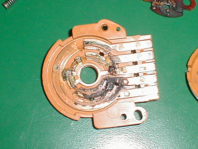

What is this part called????
Hey guys i have been smelling a burning smell when ever i turned the ac/heater on. I took the control out and smelled it again where this part is so i figured its the part. well i took it off and took it apart to discover it is just about burnt into! If you guys have any idea what it is and if i can get a replacement part instead of the whole control let me know please!!
thanks,
kyle

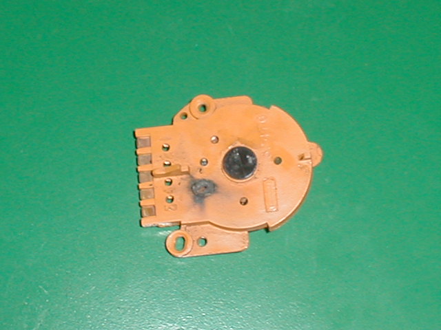

another

Take it to your local GM parts dept. and show it to them. You should be able to get it separately.

That my boy is the A/C mode control switch in the A/C control head. Your best bet is to go to a junk yard and get another unit from a junked car.

did it burn b/c its just old or do i have another problem?
It appears to have burned because of old age. I haven't seen it happen very often but it does happen occasionally.
