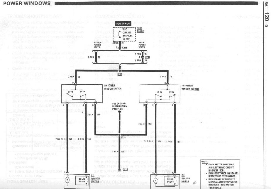

This circuit is similar to the headlight wiring harness upgrade. Instead of having the window motor get power thru the window switche, the power for the motors are run thru a relay. One relay for "up", one relay for "down".

does anyone have a page out of the shop manual for the wiring on the windows? I doubt that the power does not go through a relay.. that would be bad wiring.. mayhaps that's just old school automotive..
anyoen try swapping in 4th gen or newer truck motors?
here ya go.
and no, its thru the switch.
