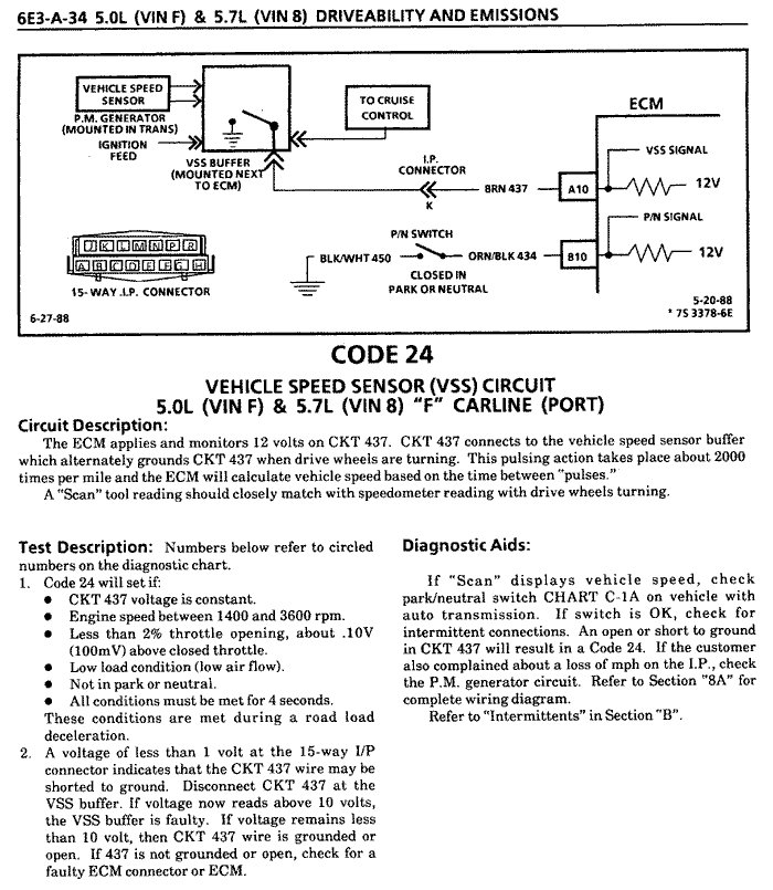

It means that you have a code 24 as I mentioned earlier and that you have a problem with the VSS system.

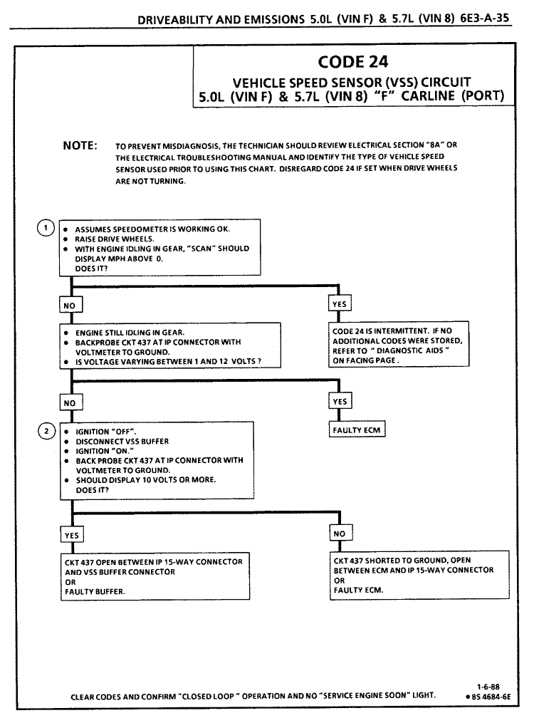

Old Mar 5, 2005 | 06:32 PM
Trickster's Avatar
Posts: 6,127
Likes: 12
From: conway, s.c.
Car: 1989 Iroc-Z
Engine: 5.7L TPI
page 2
