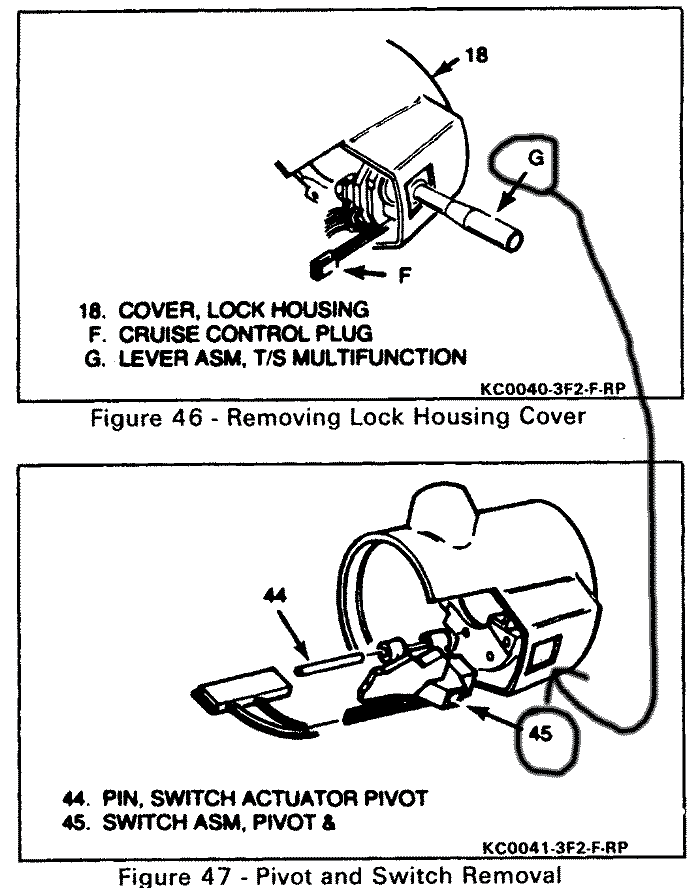

What you may wind up having to do is replace the turn signal/wiper switch inside the steering column.

The metal rod that connects to the switch? is this switch you are talking about? where is this switch located inside the coloumn?
That metal rod you are asking about is the rod that goes to the dimmer switch and has nothing to do with the turn signals or the wipers.

you are correct about that, but when you install the turn signal arm, there is a metal rod that attaches the turn signal arm, so when you twist ( turn on ) the wipers doesnt it move that arm?
Where exactly is the wiper switch located?

here!!
