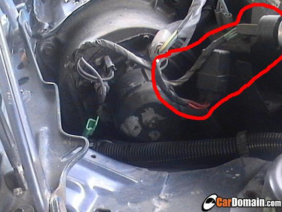

Other connectors/relay
The circled connectors, what are they for?
If they are for the AC.....
If I have deleted my AC system can I cut these out of the wiring harness?
Attached Thumbnails Mystery connector-c-documents-settings-gentilej
Old Mar 30, 2005 | 07:21 PM
meridius's Avatar
Joined: Jun 2001
Posts: 1,012
From: Allensville, PA
Car: 1988 Trans Am GTA
Engine: 5.7 TPI (Now HSR)
Transmission: 700R4 by Probuilt
Axle/Gears: 3:27 9 Bolt Posi W/ Discs
well the round one is to the AC low pressure switch so yeah you can do away with that if you want but the other one is to the blower relay ?resistor so youll need it for the blower to operate properly.
