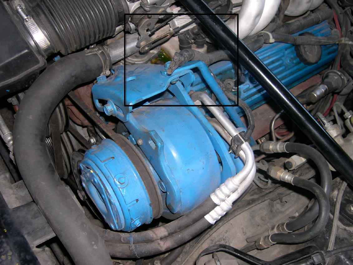

Pictures finally.

I could be wrong, but from first glance it looks like the AC clutch connection that would go in between the clutch and compresser housing. Mine is at the 2 o'clock position when facing the clutch side of the unit.
If you just spun the camrea from where it was at to just behind the clutch it should be there.

I didn't see any extra connectors on the AC compressor anywhere... is it covered by a support beam or housing somewhere? There is one connector already plugged into the compressor.

It's actually on the clutch, not the compressor.
There's two flat prongs that fit into the connector. Mine is actually at the 3 o'clock position. Look at the plug and then in behind the clutch. i think it goes there also because of the shape of the wiring to the connector. It as to curve like that so it doesn't interfere with the clutch and belt etc.

That is the AC Clutch connector. I have the exact same connector on my 82 Firebird.

So it plugs in somewhere on that blue monster?

I figured out where it goes. Now the problem is that the connector is too short, it had electrical tape wrapped around it so I peeled it off and there is a little resistor connecting the black and green wire. Is this normail or have I found another red neck hack from the dip**** previous owner?

Thats not a resistor, its a diode. The diode will cause the field of the AC clutch to collaspe faster so the the AC compresser will stop faster.

I was wondering about that. Mine runs from underneath and around the outside. Somehow you need to route it differently.
Try following the wiring back to the main harness and see if you can untangle it and bring it around the other way. I can check tomorrow if you need and maybe take a pic if necassary.

I can't tell. mine is a 2.8 so i'm not sure if they're the same anyways. When i looked, the open part of the plug is facing toward the front of the car. Also the connector runs pretty much straight from the harness to the connectors on the side farthest from the engine.
I looked at the curve of the wiring from the connector to reconstruct how it plugged in.
