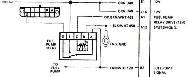

I've attached a truncated schematic that I found in a post from Vader. I've cut out everything except for what I wrote about above. Note: You've got an oil pressure switch, but I do not know if it would play a part in your system. Need input from a TPI guy on this...and if this does not match your ECM, the terminal designators will not match either, but the schematic should be the same for most everyone, I believe.

a couple things i would check looking at the relay wiring diagram:
-First of all check the fuse, there is an inline Fuse near the battery (about 6 inches down the wires a 20A ATO in a black rubber holder), it has a red and orange wire coming out of the rubber holder i believe.
- do you have 12v at the E terminal on the Relay? if you are, is there 12v coming out the A terminal with the key on?
- are you getting a 12v signal at the C terminal on the relay (key on)?
- do you get ground from the B terminal at the relay?
- check at the ECM if you are getting any power from B2
- a wire may have rubbed on the chassis somewhere and is grounding out!?
i may be VERY wrong here cause i am not 100% sure Exactly how the circut works but:
i would imagine it is in the "fuel pump relay drive" part of the circut. it looks to me as if the "prime" signal comes from the B2 pin at the ECM, and the power sent through the relay runs the fuel pump when the car is running.
Well that gives you a checklist to start with, (Vets please correct me if i am wrong) if these things all check out, i think i have read in these forums that a faulty Oil pressure switch can cause the fuel pump to not fire up!?...
Good Luck!

Looks like the Skunk covered about the entire circuit. Just don't overlook the grounds for the pump motor itself.
If you are measuing 12V to the pump during the 2-second prime cycle, the ECM and relays are probably working correctly. The pump will not get power again until the ECM reads distributor reference pulses (distributor and engine turning) or you shut off the ignition for 20 seconds then turn it back on to initiate another prime cycle.
