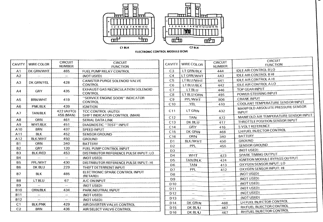

ok i have the computer out of the car...there is a long block of wires plugging into the computer and a shorter block...where are the d7 and d6 pins into the computer?

Originally posted by jazzcat2001
Here is a picture of the connectors in the ECM. Please note the two areas marked in black, those are pins "D6" & "D7" in connector "C2".
