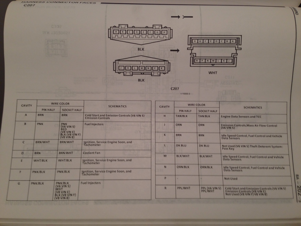

Looking for the pinouts to this connector. It is located near the two ECM connectors on my 87 IROC. Can't seem to find a reference for it anywhere.
Unfortunately I had a sudden move and have not been able to get everything I have for my car that is still at my old house, including the printouts I'm referencing here
But, good news is I have an 89 shop manual(the GM one) so I will take a peak in that tonight and see if I can't get a good enough picture of the diagram and post it up here
I think I have exactly what you need, if anyone has access to both an 89' shop manual and a scanner before I do, it is page 8A-202-3, connector 207, it has the full pin out, I will post as soon as I can get a decent scan or picture of it
EDIT: Got it, let me know if you need a better picture

Thanks Caveman. That's what I needed. I had wires from pins C, E, and H that had cut ends of the harness, and I had no idea where they possibly went. Looks like the H is not used, since this engine is now in a 5-speed car. C and E go to ignition/service engine soon/tachometer, according to the pin-out, and I think I might now know what wire might have fed these, as I had a pink/black and black/wht wire with no home. I'm thinking they went to C/E. Still trying to track down how the fuel pump wire goes from the fuel pump relay to the chassis harness. According to one poster, it comes to C207 at pin L, but that appears to be part of the passkey circuit. Any idea how/where the three wires from the fuel pump harness make their way up to the dash area, and how they actually connect to the relay on the engine side?
Does your 87' have vats? Remember this schematic is for 89' it's close but it may not be 100%, it's possible that the other poster is right that instead of passkey it is your fuel pump wires

Re: Possible Useful Link for ThirdGen Wiring -
Nope. No VATS on this car...
