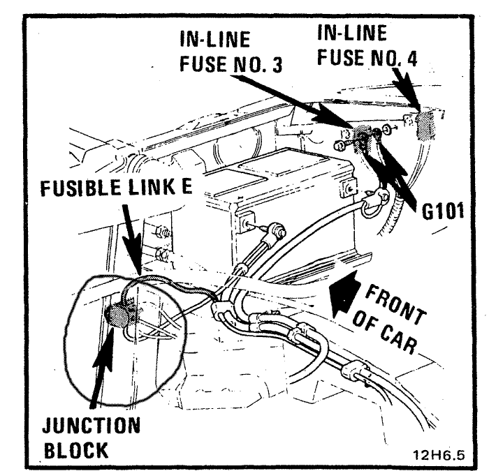

In my manual it says that the wires coming from my starter solenoid goto the "Junction Box". What do they mean, is this the fuse box, and if not, where is the "Junction Box"?

On some models there is a "JUNCTION" block located up near the battery close to the radiator. That is what the chiltons is referring to. Here is a picture of what I am talking about.
