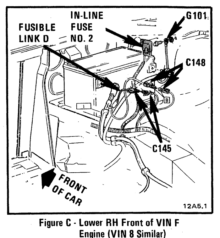

I have an 88 Iroc with a .040 over 350 with tuned port injection. If my car sits more than a day or so without being driven the battery goes dead. I bought a new battery and still have the same problem. Today I went through checking wires and connections and found that there is an orange wire that comes off the positive battery cable about six inches from the battery terminal. It has a weatherpack connector that then goes into a bunch of wires. The weatherpack connector is burnt up. What is this wire and is there supposed to be some kind of fuse in this. Does this seem like it could be my problem. Thanks for your help!

There should be two of those connectors there, they are fusible links connectors.

Its right after the fuseable link. The orange wire comes off the wire that goes to the alternator.

Does it look something like this?

Yes it does, it is either c145 or c148

They are both fusible links connectors.
