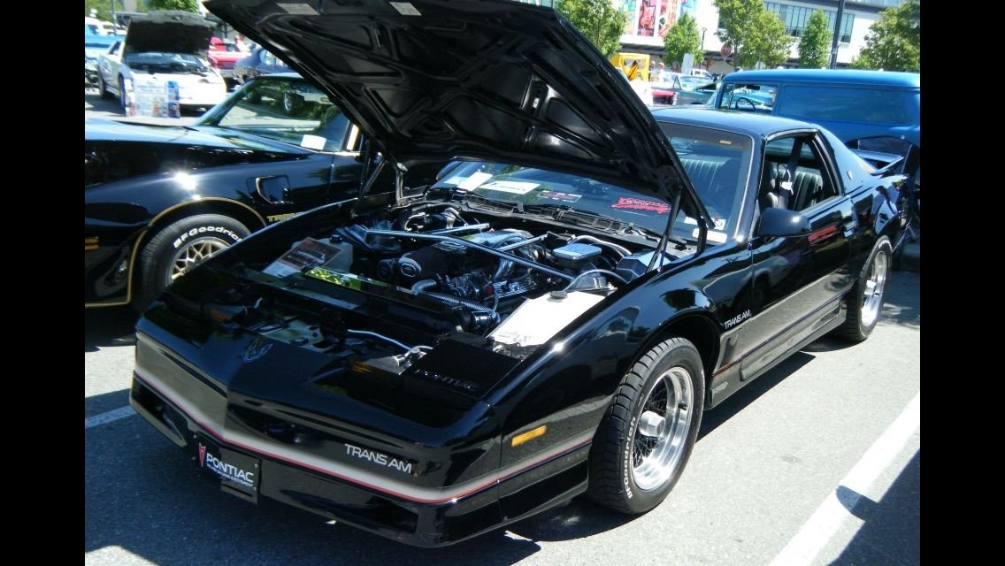

Hi. Haven't driven my 85 Trans am in about a couple weeks took it for a burn today and is running pretty rocky at about 3000rpm. And idling a bit rough and seems to have a bit of power loss. It's a 91 350TPI. Any suggestions on where to start? Looked under the hood and everything appears fine. Battery wasn't dead or anything so I don't believe I wiped out the computer and gave it fresh gas to rule out bad gas. Any help would be greatly appreciated because no performance shops locally know how to tune this motor.

This being the monster.
