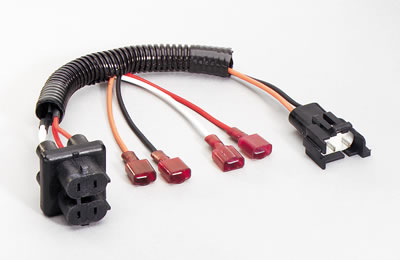

To install a MSD 6A on a camaro -88, is this all you need to do?..
First the MSD 6A ( of course )
Then this wiring setup from MSD.

if you use the plug in harness, you don't do the install like mentioned above, you just plug everything in.
Here is a link to the instructions for a 6-series ignition.. Instructions

THanks for the answer.
I did read the manual, but my english is bad so I just need to clear som things out
Did I get this right?
Original there is 2 connectors on the coil. If I use the plug in harness there is only one connection going to the coil, right?
The other orginal coil connector is instead going to the MDS?
Thanks.

CORRECT PLUG
goes right on
both existing coil connectors go to harness
then one to coil
fits only one way
