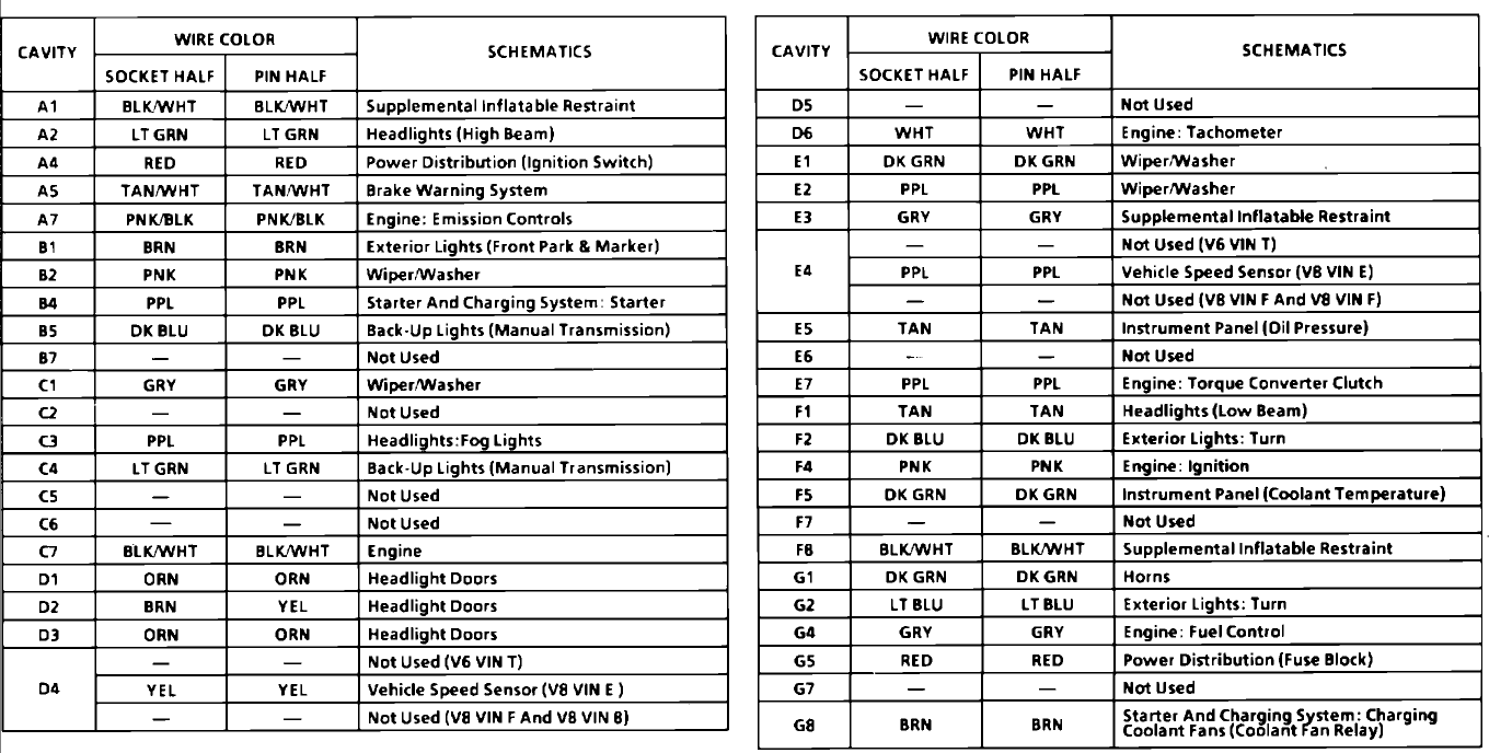

Where to find a wiring schematic for 92 TPI?
Would like to put new motor with Holley commander 950 in. But need to intergrate old engine managment harness out and new harness in. Would still like to retain headlight part of the harness. Where do I get wiring schmatic?
The headlights are on a different harness than the engine is. But, if you must ask...
Attached Thumbnails Where to find a wiring schematic for 92 TPI?-41844895.gif

And here is the bulkhead.
Attached Thumbnails Where to find a wiring schematic for 92 TPI?-41844886.gif

the bulkhead connector that is located on the passenger side inner fender down near the rocker panel is that all engine management?
By the way thanks for the schmatic.
