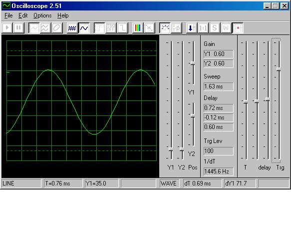

Free Software works OK
I've been experimenting with the freebie software on my old P166 and soundcard. It's okay, but the software only works with the card in 8-bit mode, so the vertical resolution could be better. It allows sampling at 11025, 22050, and 44100 samples/sec - so that's not bad.
My Dirty Bird is stored for the winter, both the other vehicles have distributorless ignition so I can't very well try interfacing the sound card inputs to a tach lead.
Nevertheless, this is a great tool for DIY EFI builders and guys tuning their EFI - this 'scope could watch injector pulse width, MAF pulses - all kinds of stuff.
Below is a screenshot of what I got, feeding a sinewave into the sound card.
