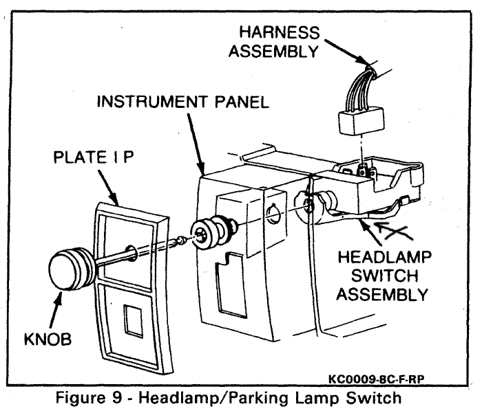

Dumb question.. How do you get the headlight switch off?
i need to replace bulbs behind gauge cluster and i cant get that off to get it out... or do i even need to get it off?

If you will look at this picture where the "X" is, you will see that it is a little clip that needs to be pushed to release the light switch rod.
Attached Thumbnails Dumb question.. How do you get the headlight switch off?-1q29.gif

thanks for the help, i ended up finding the repair manual and got it. But i also found that the retainer piece that screws in broke off inside the housing.. so now i gotta go to the junkyard :-( thanks for the help though
