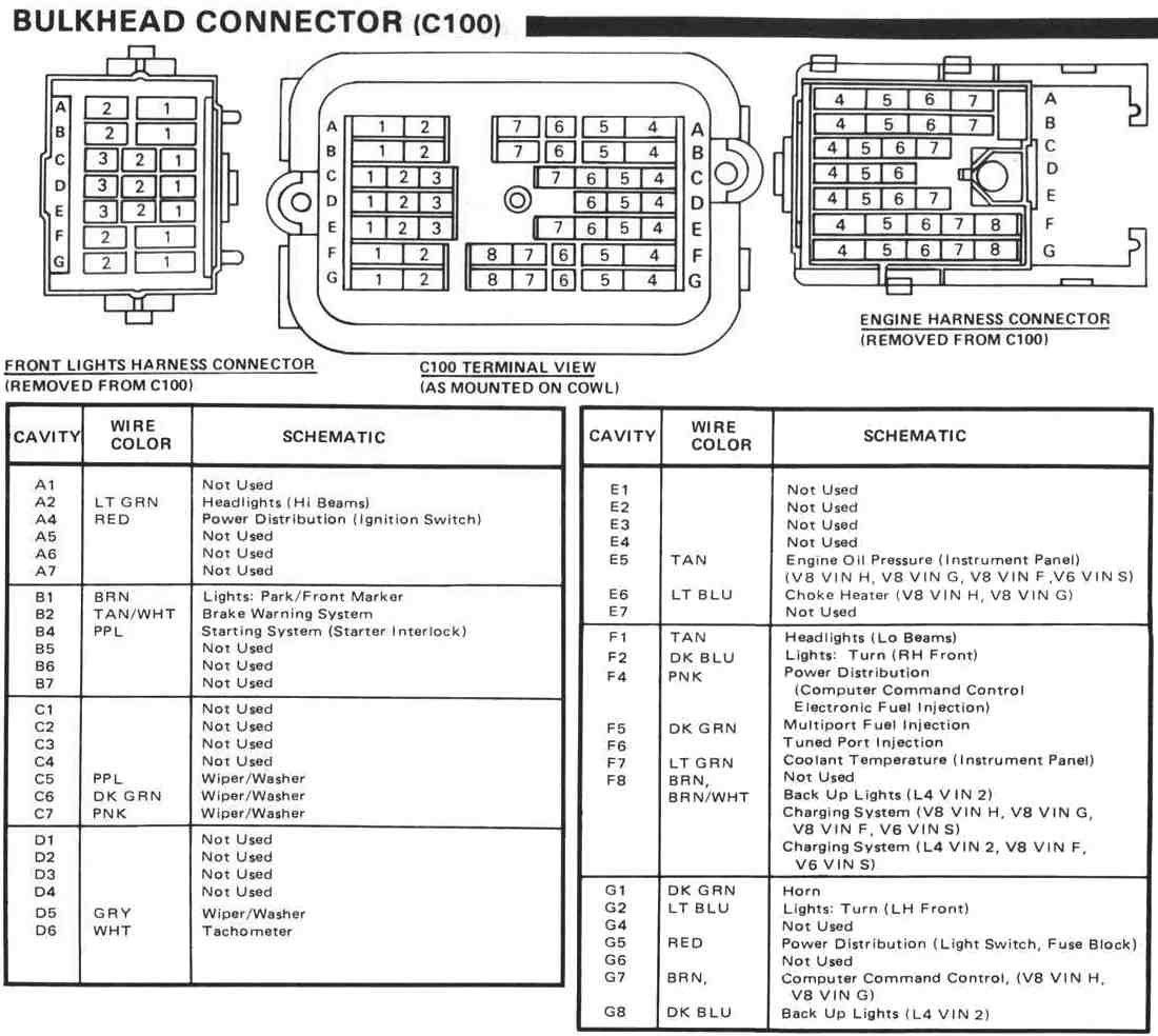

does anyone have a pin out of the harness plug on the firewall by the master cylander and brake booster? i sold the computer& harness and want to run power to the factory fuse block. i have another harness, but it has been butchered.

That is also commonly referred to as the "C100" connector. I'm not sure about which year you are asking, but this is from an '86:

thanks vader! my car is a '91, but it looks like they are similar enough for me to use the info you gave.

I also need the diagram for a 91 C100
Does anyone have it, that they could post here?
I think there might be some difference between the one already posted here, and the 90-92 style.
