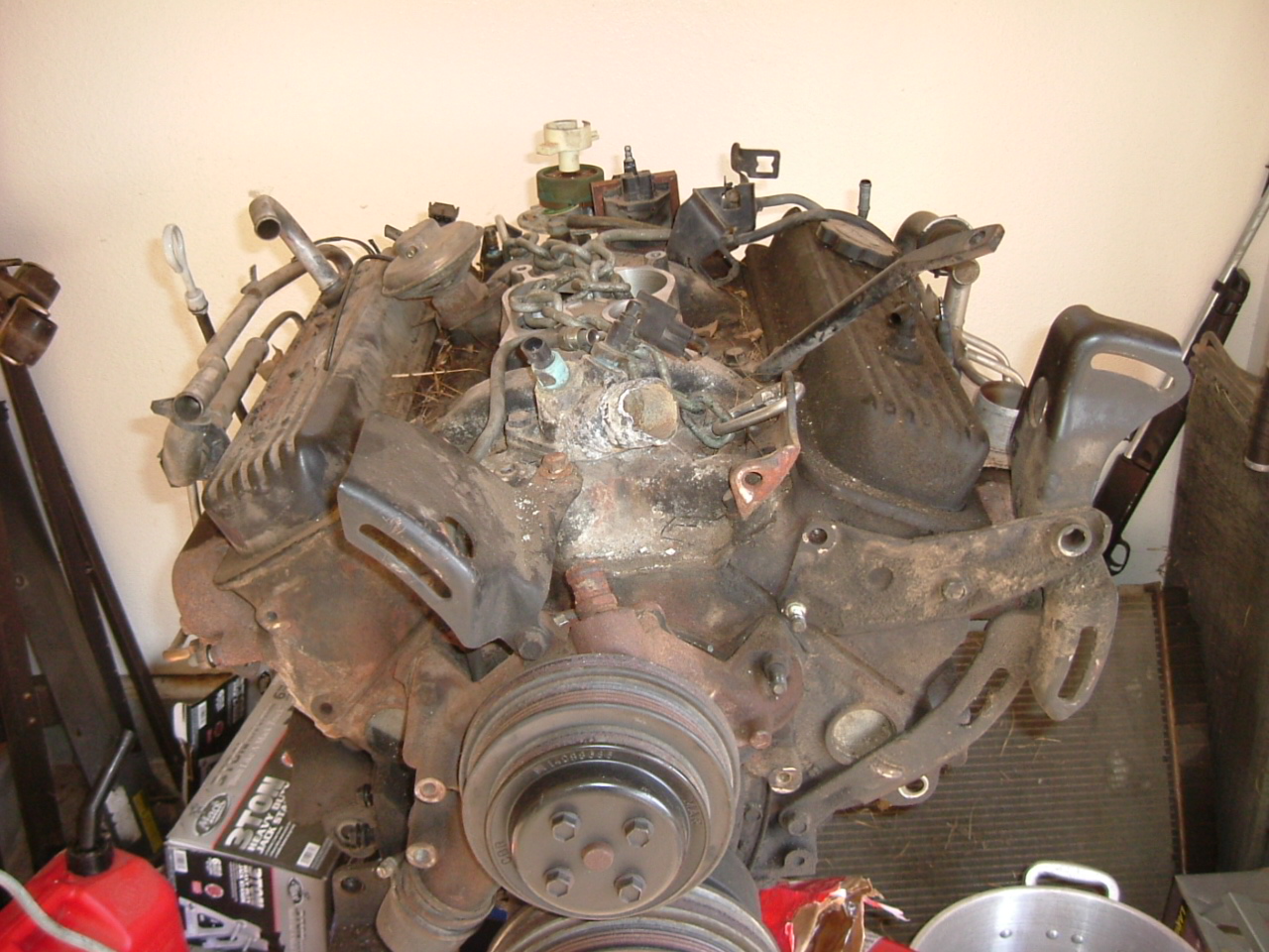

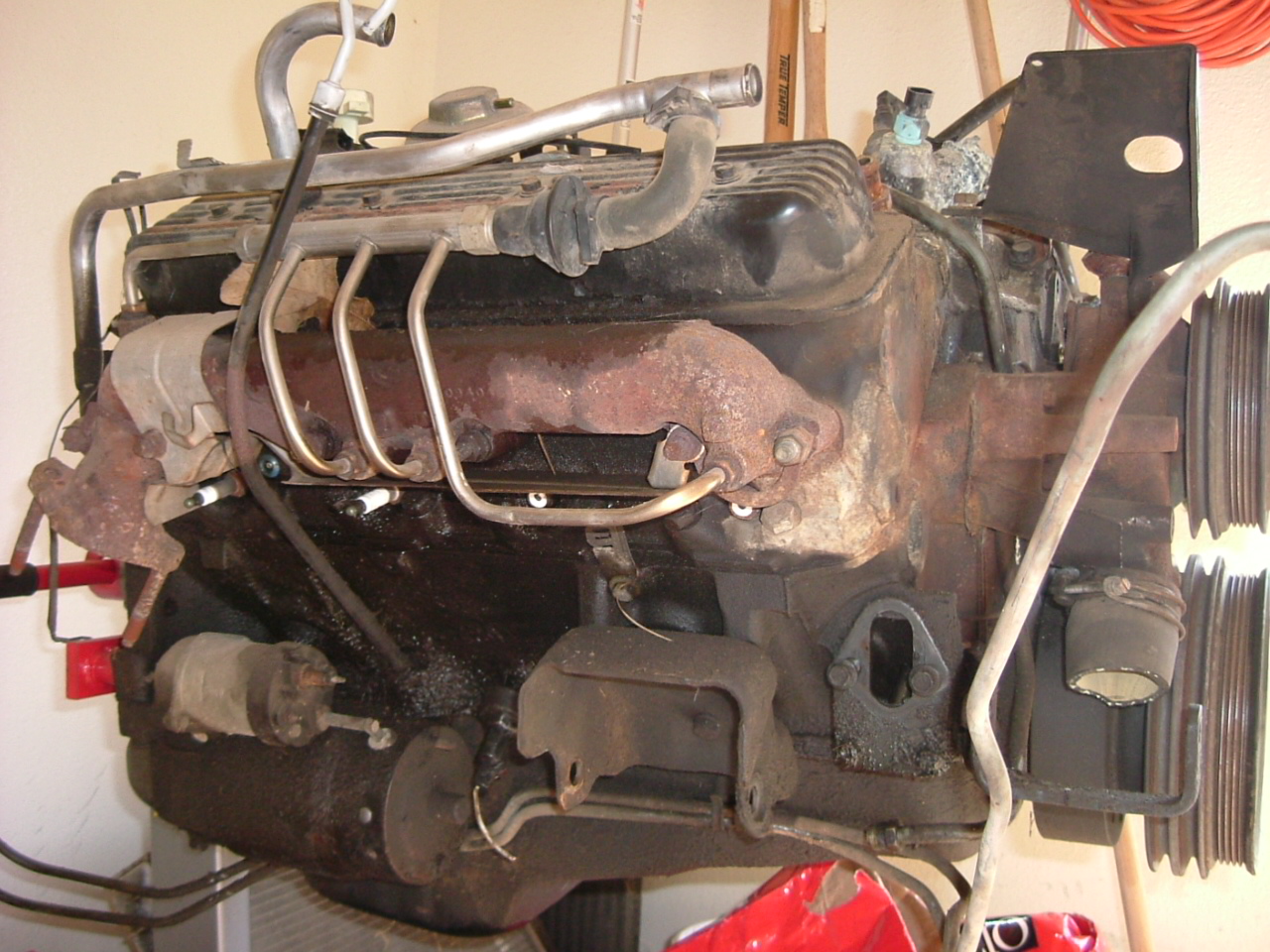

Photos
All I know is what I was told. According to my father-in-law the car was purchased directly from the Texas DPS as a salvaged vehicle and the engine was not swapped. According to him it is an LT1. Now you know why I am asking for assistance. Here are some pics I took of the engine. Hope this helps. I didn't get a chance to start the teardown of the engine today. Hopefully I can get time tomorrow.
Attached Thumbnails Need help with wiring-dscf0408.jpg   Need help with wiring-dscf0409.jpg   Need help with wiring-dscf0410.jpg

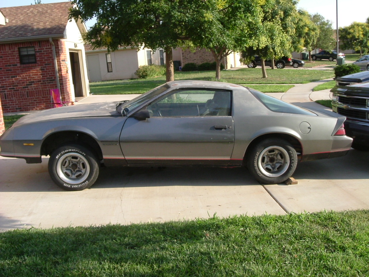

'87 Camaro body
Here is a pic of the body.
Old Jul 20, 2006 | 08:55 PM
AC's Avatar
AC
Joined: Jun 2000
Posts: 1,680
Car: Used to drive a camaro
Desrt, that looks to be an 87 305 TBI not TPI and not LT1 for sure. Look on the rear engine block where the bellhousing would bolt up and clean off that area looking for casting numbers. You should see an L03, L98 or something. But I'm certain that's not an LT1's were 350 CID not 305 and used Optispark dizzys. The LT1 dizzy was behind the water pump.
Old Jul 20, 2006 | 09:34 PM
cadman277's Avatar
Joined: May 2006
Posts: 133
From: Ohio
Car: 95 z28,86 iroc
Engine: 350 lt1,305 tpi
Yes they are right it looks to be a 305 or 350 throttle body engine.
Old Jul 21, 2006 | 02:10 AM
DesrtScrpn's Avatar
Joined: Jul 2006
Posts: 4
You guys are good! I decoded the Engine number (once I found it) and it is a 305 manufatured in Flint May 4, 1987 and has the suffix code of SDB which does in fact indicate a 305 engine. I looked at the back bell housing mount and found the GM5.0LG stamp there. I could not tell for certain even after cleaning it up if it is 5.0 or 5.8 but the engine number on the front confirms it for me. I guess I will press on with the teardown in the morning and go from there. I am sure I will be visiting this site soon to bother you with more questions but I really do appreciate your time. Thank you.
