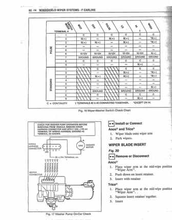

Did you just replace the motor, or the entire motor and electronics? Your motor is good, the problem is in either the park circuit or an open in the wiring. Does your system have delay and pulse washer?
I have the '88 service manual, but I won't have access to a scanner until tomorrow. I'll scan the decision tree and wiring diagram & send tomorrow.

Wiper Pages from Service Manual
Attached might help you get your problem solved
