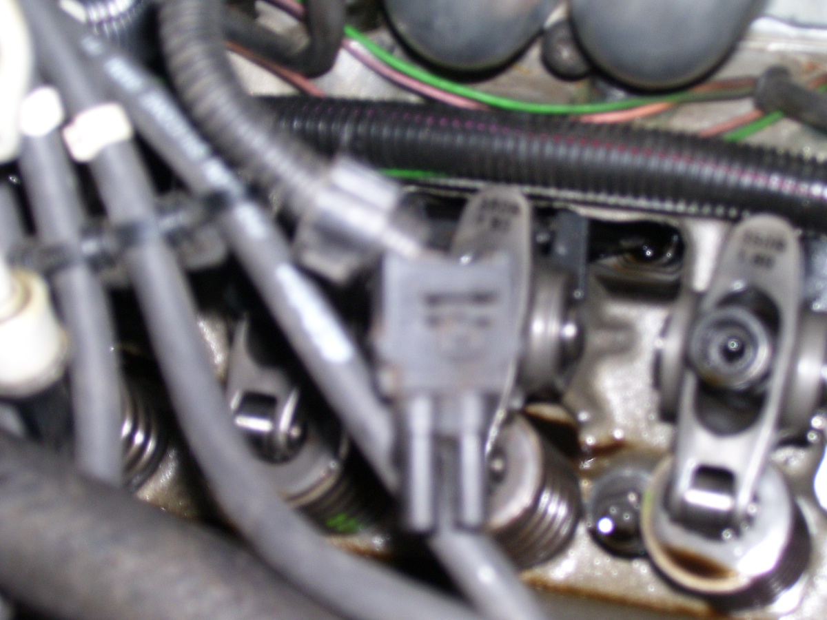

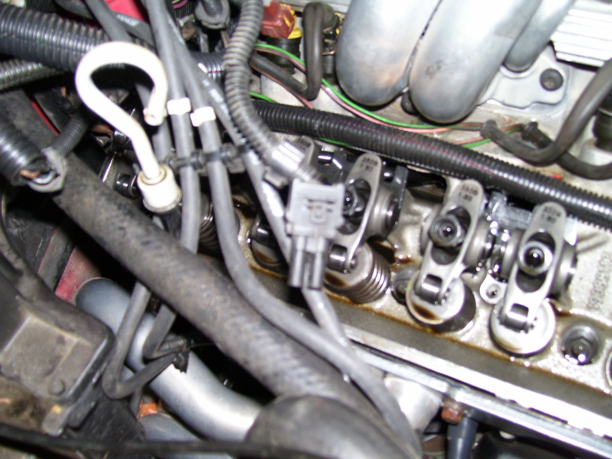

Well, first we're going to need a picture something of this disconnected plug.
Did you try an inline spark tester? It would be very helpful to see if you have spark.

heres a try at a pic of that plug.What could have fried my ignition module.

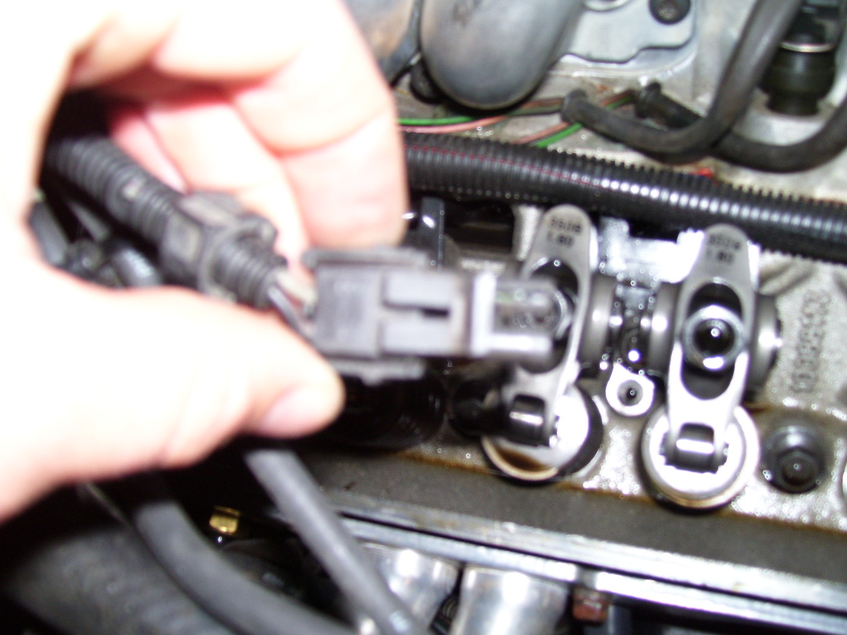

one more.

I can't make out any wire colors out of the pictures. What colors are those two wires? Make sure you look at the whole circumference of each wire, they might have a thin stripe.

That loose plug appears to be the one that goes to the smog pump. That sounds like what happened when I fogot to hook up my MAP sensor once.
