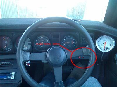

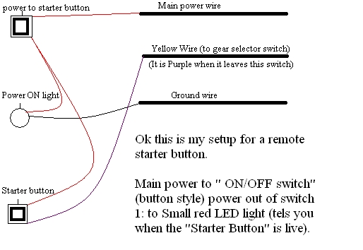

Here is my setup and location, Hope it helps someone out.
UPDATED PICTURE:
Attached Thumbnails Push Button Start for 86 Z-28-image000-2.jpg   Push Button Start for 86 Z-28-starter.jpg
