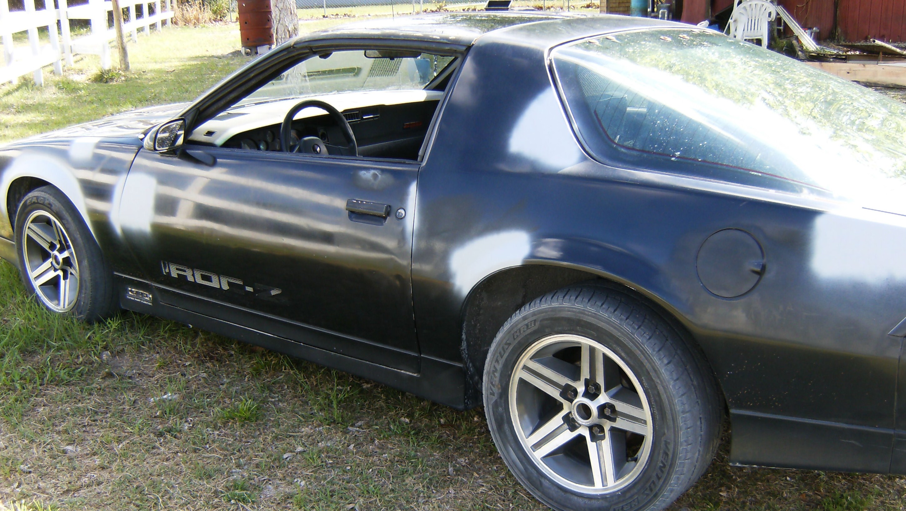

kinda sounds like i have the same problems that all of you have. not sure though. my 86 iroc tpi surges in just about ANY cruising speed 30,40,50 mph etc. etc. but once i give it a little bit of throttle it smooths out. i let off the throttle and it surges while my 700r4 downshifts. when i take off from a stop the trans shifts fine until cruising speed. then it seems like the overdrive is slipping but its NOT. would this vss sensor cause my converter maybe not engage in proper lock up as well??? please help thanks
No. Your car has a cable driven speedo. I think there is a sticky in the faq board or a tech article about speedo cables jumping. as far as your shifting issues I would first start by adjusting the tv cable, there is a tech article about how to do that. Also check the fluid.
